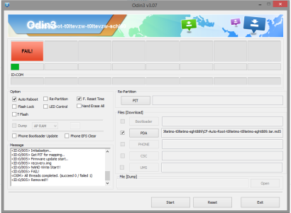

I'm trying to copy over application data to the newer phone that I got used using Titanium Backup. I'm on gousmobile dot com now for service (which uses T-Mobile's Network), hence the change in the phone. I just did this with the same USB cable and port on the T-Mobile Note II (following different instructions of course - tinyurl dot com forward-slash pnawx25 ), so I doubt it's a faulty connection or hardware issue. I've done this a handful of times now but I don't understand what is wrong here to know where to proceed next.
Yes, USB Debugging is enabled. Yes, I have made sure that the phone accepted the RSA fingerprint thing from my computer before starting this process as well. Hoping someone has an idea of where to go from here! Thanks in advance.

Screenshot of Odin -
Log from my Attempts using Odin 3.07

Code:
<OSM> Enter CS for MD5..
<OSM> Check MD5.. Do not unplug the cable..
<OSM> Please wait..
<OSM> CF-Auto-Root-t0ltetmo-t0ltetmo-sght889.tar.md5 is valid.
<OSM> Checking MD5 finished Sucessfully..
<OSM> Leave CS..
<ID:0/005> Added!!
<ID:0/005> Odin v.3 engine (ID:5)..
<ID:0/005> File analysis..
<ID:0/005> SetupConnection..
<OSM> All threads completed. (succeed 0 / failed 1)
<ID:0/005> Removed!!
<ID:0/005> Added!!
<ID:0/005> Initialzation..
<ID:0/005> Get PIT for mapping..
<ID:0/005> Firmware update start..
<ID:0/005> recovery.img
<ID:0/005> NAND Write Start!!
<ID:0/005> FAIL!
<ID:0/005> Removed!
