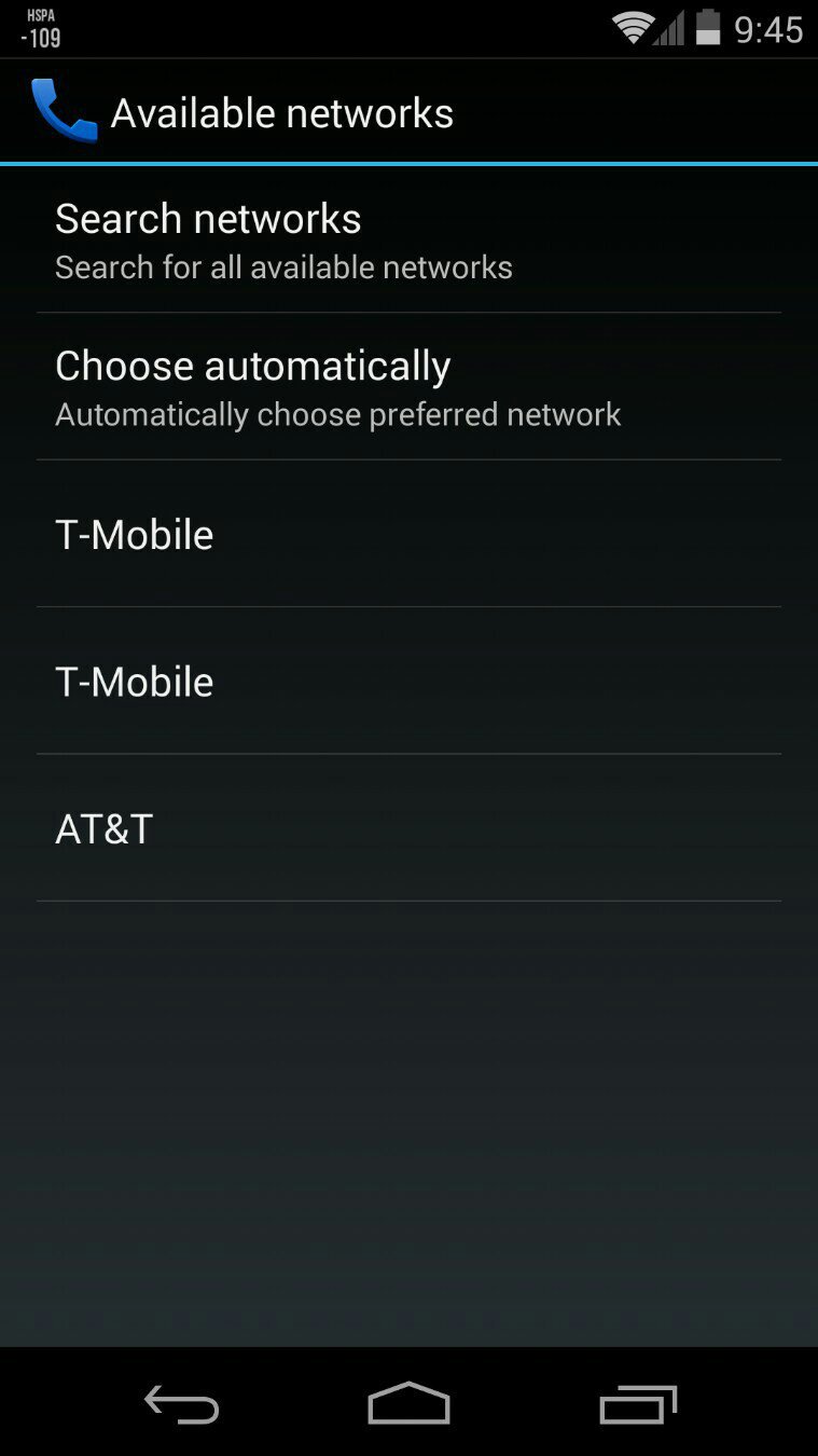

Where does your network settings list Sprint? I can't find any such setting on my phone.
turtleparadise
Jul 13, 2010
78
Visit site
Re: Swapping Nexus 5 SIM from Sprint to T-Mobile
Under settings-> more-> mobile networks-> network operators.
Sprint is not currently listed because I'm using T-Mobile now, but after putting my Sprint SIM back in and factory resetting, it would be listed.
Sent from my Nexus 5 using Tapatalk
