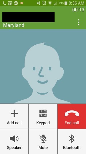

My S5 is from EE, and has a big cartoony picture of whoever you're calling taking up most of the screen, plus a couple of buttons.
I'm not sure how to change this- none of the options are obvious. How can I access the keypad during a voice call?

Does your dialer look like this?
It should have the "keypad" option at the bottom. If not, you should be able to hold down on the left capacitive button and that will bring up the options menu.
