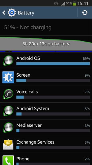

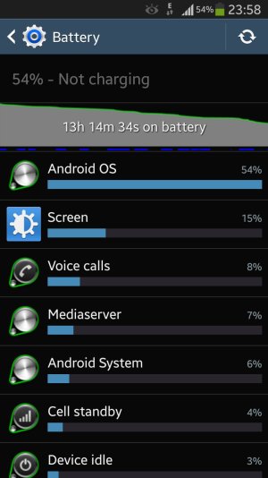

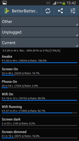

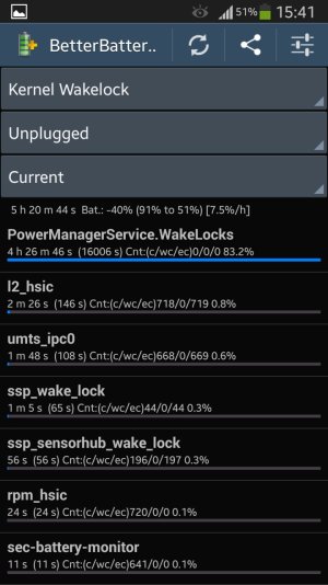

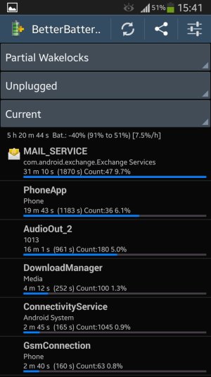

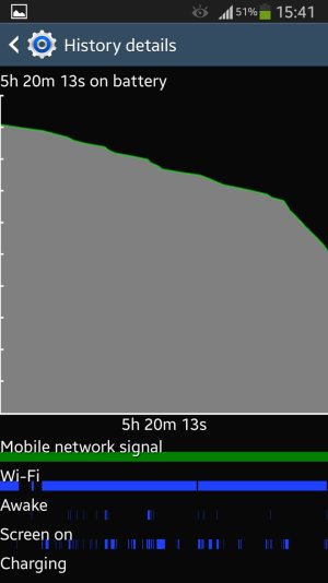

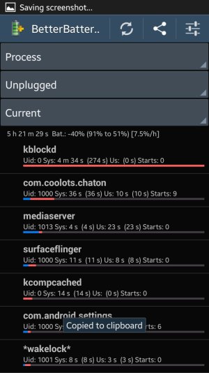

Dear experts,
Once again i seek your guidance..I'm really getting sick of androids and probably shift to the dreaded iphone now.
Phone state:
GPS off
Mobile data off
Wifi - off when in sleep
All motion sensors are off
All location services including google's are also off
(whats the point of having all these off if i have these available)
Still getting excessive battery drain. Sometimes phone is warm to the touch even when not being used.
Used battery stats to check whats up but i dont know what its telling me. Please view the screen shots and guide.
Also noticed that when i set the phone to sleep at night with wifi..then battery drain is less and if wifi is kept off, then battery drain is more. And its always the "Android OS" ..HELP!

It looks like there's a lot of sync activity going on. You might try going to Data usage in Settings, tapping on the menu button on the bottom left of the phone to bring up the advanced menu, then make sure that "Auto sync data" is NOT checked; if it is checked, tap the box to un-check it so it will be turned off. See if that makes a difference in the Android OS battery usage (it really makes a difference on my phone).

Yes , true.I charge my device everyday.If you want to squeeze out two day battery life or 1.5 day battery life , then that option can help to save battery life to a certain extent but the problem is background tasks or cache will be suffering a lot which degrades the performance.
I had Wifi turned on for like 15-16 hours (see the blue bar at the bottom near Wifi) , which didn't effect the battery life much.
Why turn off that feature and degrade performance (i.e background tasks/caching) when its not going to give considerable benefit ?

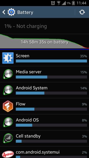

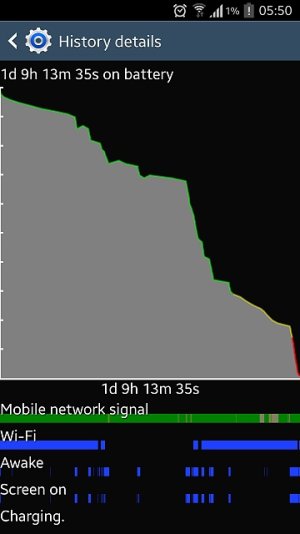

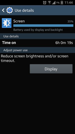

View attachment 109032Tried ur instructions.. So far so good.. I think clearing the play cache worked. Android os is still on top though.
Thanks
I will post my recent screenshots :
What is the screen time for the above screenshot you posted ? What I observed is that if I use more screen time , Android OS is reducing.
It looks like our phones are building cache when they stay idle for long.

I dont know if you've found a solution, but I was struggling with the same issue. Android OS was always +60% draining my battery, it would never last +14 hours even when idle most of the time. I tried everything, I made several threads here and no one could help me. I figured out that my phone was being kept "awake" by this wakelock l2_hsic. After trying several different kernels, modems, ROMs, nothing worked. Until I flashed a 4.2.2 version ROM, now my Galaxy S4 lasts 24 hours minimun, even if I use it moderately. The most it has lasted was 1d 19h. I don't know if this will help at all in your case but I just thought I'd share. Good luck!
Also, turning off sensors, GPS, location services (the many different things people always suggest to turn off) didn't help at all. Now I have all those things on and my battery life is fine, they aren't the problem.

I don't remember the screen time but you are correct..more screen time reduced the android OS percentage.
