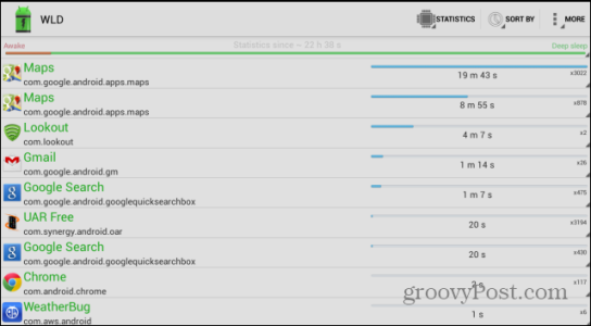

Here is a screenshot of a phone that has been held awake by the Google Maps application.
Likely causes: Due to the app being in use, meaning that the phone's GPS is on.
Possible solutions: Turning off your GPS after using the app, or turning off location services within your phone's settings. Navigate to settings > personal > location and turn off location reporting. If that doesn't work, you'll want to go into settings > device > apps > maps, and clear cache.

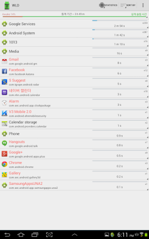

Shown below is a screenshot from the WLD Play Store images. As you can see the app Kakao Talk and Facebook have kept the phone awake for 13% of the time since boot. For this one, we'll focus on Facebook as it is far more commonly used.
Likely causes: The app is set to push notifications to you, meaning it is constantly checking for messages, replies, likes, etc. or the app is reporting your location
Possible solutions: Turning off push notifications/location reporting for the app. To do this open Facebook > app settings > and change your refresh interval to something longer than what it is currently set at or turn off the messenger location services. The latter can also apply to the "Facebook Messenger" app.

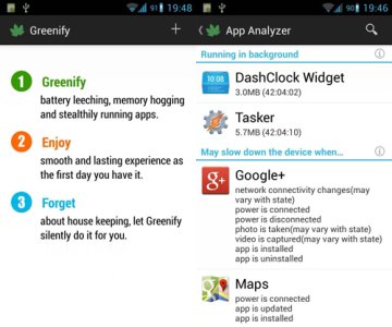

[INFO]For any rooted users, if you are still having trouble with battery drain, you may want to try the app "Greenify." It lets you put apps "to sleep" and will only wake them when opened. This will prevent any wakelocks, both partial and full.[/INFO]
Link to the play store: https://forums.androidcentral.com/e...ails?id=com.oasisfeng.greenify&token=lwM0Qcbs
