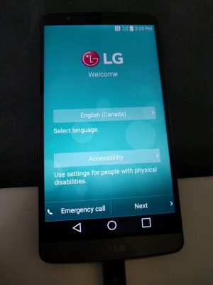

Tried to flash TWRP but phone wont boot now, i get the secure boot error message when I turn the phone on. Same thing when I try to go into recovery mode. Only thing that currently works is the download mode. Is there any way tor recover from this or am I SoL? Btw its the D852 variant.
EDIT: FIXED IT!!!! Thank you LG for your great device support and having a fix for user stupidity!! I honestly thought this device was long gone after weeks of searching for a fix but I found this and voila! It worked!

8. Proof that this worked and my phone being alive again!
I hope this guide helps anyone who runs into a similar issue. You're welcome guys!
