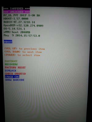

Bricked my Tmobile HTC One M7.HELP
So I did something pretty dumb yesterday. Installed the HTC Sense 6 update on my HTC ONE M7, hated it so decided to root my phone to revert back to Sense 5.0 or 5.5 or potentially try a custom ROM. Downloaded a Tmobile 4.3 JB RUU, downloaded android SDK, HTC sync manager, Fastboot. I unlocked boot loader, installed Wheaton recovery by Koush, installed SU, figured phone was rooted but it wasn't. Now I've somehow succeeded in deleting EVERYTHING. Phone continues booting into recovery. Commands using Fastboot aren't recognized because it cannot find any device. When plugged in via USB, PC recognizes that something is plugged in but that's about it.
M7_UL PVT SHIP S-ON RH
HBOOT-1.57.0000
RADIO-4T.27.3218.14
Open DSP-v32.120.274.0909
OS-5.14.531.1
eMMC-boot 2048MB
May 9 2014, 15:00:26.0
HBOOT
<VOL UP> to previous item
<VOL DOWN> to next item
<POWER> to select item
FASTBOOT
RECOVERY
FACTORY RESET
SIMLOCK
CHECK SMARTSD
IMAGE CRC
SHOW BARCODE
