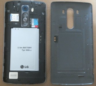

have a D858HK, the connectors in back cover is in a diff location.
Any one can come across this, where can I find a quick circle case with wireless charging?IMG_20150504_125410-1.jpg

There is a replacement qi/nfc board on banggood dot com which makes this work with the D855.
For the AT&T model and other D850 models, sorry. You will need to buy a default qi charger with a connector that goes thru the phone case and down to the charger connection. But it is practically invisible. Sold at the same website (cannot post links), search for wireless charger and they're both on page one. They have the chargers too, and all of it for practically nothing.
