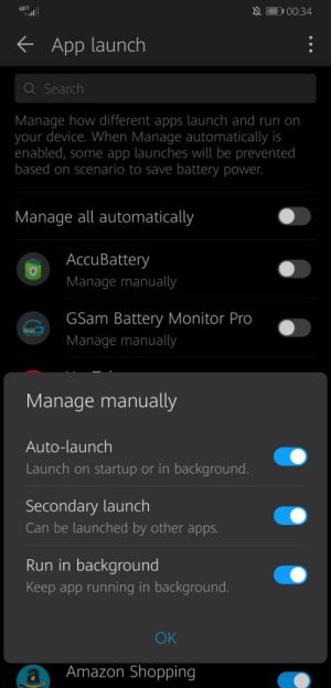

In app launch , under Battery settings set those apps with following options. Make sure they are all set to "manage manually" and that the 3 sub contents in each box is ON. Attached pic , in my example it's Accubattery Pro and GSAM.
Also check under Apps, then battery optimization, pic also attached. Make sure those apps are set to not allowed. Then reboot and clear cache.
If all that still doesn't work, you will have to follow the attached link , reference Powergenie. I have power genie still running on mine as I don't have notification issues .
https://dontkillmyapp.com/huawei
Screenshot_20191218_003438_com.huawei.systemmanager.jpgScreenshot_20191218_003719_com.android.settings.jpg
View attachment 314387View attachment 314388
