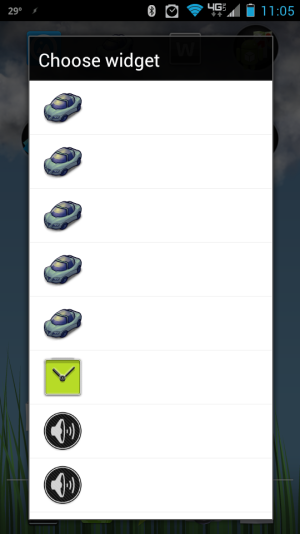

fatboy97 - are you running Nova Launcher? When I am running Nova Launcher and get to the "Choose Widget" view it looks lie this: (see attachment)

I am also using Nova Launcher Prime v1.1, on a Droid RAZR MAXX with ICS v4.0.4 and I get the screen shot I posted above. I wonder what is different between our phones?

Kevin, the developer, gave me some detail on the issue:
Kevin @ TeslaCoil said:
Due to technical limitations, third party apps in Android 4.0 have to use the system provided widget picker. Unfortunately Motorola has designed their's this way. With Android 4.1, or root on Android 4.0, Nova can display it's own widget picker that is properly themed.
While my ICS 4.0.4 MAXX is rooted, it still wasn't working, and when I told him that he responded:
Nova might not realize you are rooted. Try enabling Nova Settings > Drawer > Widgets in drawer which should prompt for root. If it doesn't check your Superuser app to make sure Nova is not being denied root access.
When I enabled Widgets in Drawer, I got the "Superuser access granted" notification, and the picker started working properly after that.
Sorry, looks like you won't have much luck unless you root.
