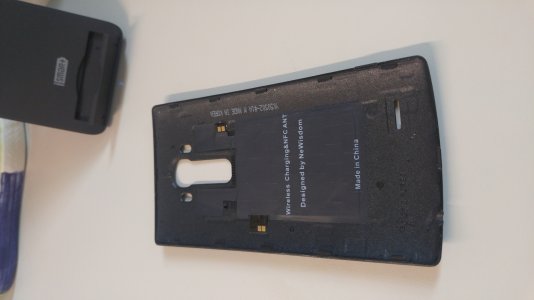

I wanted wanted to share my experience upgrading/ hacking my sprint leather back to accept the Qi wireless charging sticker.
Ordered the following items from Amazon:
Sticker: (only one I could find actually shipping from the US)
Amazon.com: NeWisdom® LG G4 Qi Wireless charging IC Chip+NFC Antenna Sticker for LG G4 H815 US Cellular T-mobile H811 AT&T H810 Verzion VS986 Sprint LS991 Korean Version F500 Battery back door cover or G4 flip case (G4 wireless chip): Cell Phones &
Charger:
Amazon.com: RAVPower Qi Wireless Charging Pad Stand (3-Triple Coil Charger, 1.5A input, Foldable Kickstand) for All Qi-Enabled Devices(AC Adapter not included): Cell Phones & Accessories
The installation was fairly easy and quick.
The back cover sits flush on all sides as it didn't original, however I noticed there is a slight raise near the near buttons on the back. Not a deal breaker just something I noticed.
As actually charging goes, everything just works. With the stand/charger I have it works in portrait and landscape. If you use the charger in stand mode the phone don't actually touch the charger (bcus the phone is curved some) there is a bit of a gap but it doesn't seems to be an issue.

Pretty good. It is kinda slow. I use it at work so I'm not really concerned with charging speed.
Also if I noticed the phone gets pretty warm/hot if I stream video and on the charger just fyi

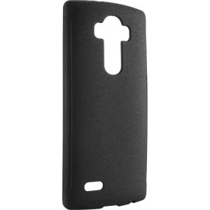

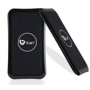

I just got my newisdom qi(upgraded version) sticker and it has to be in an exact place to charge and if I have a case on it wouldn't charge. I was wondering if my sticker is defective or that's how weak it is? My case is pretty thin too. I have a lg optimus g pro with a silicone case that can be place anywhere on the pad and it charges. Here is a pic of my case and charger pad. insignia case g4.jpgItian wireless charger.jpg
