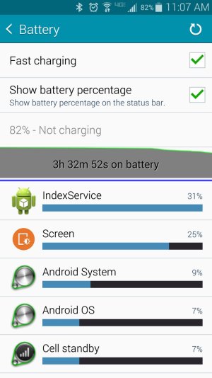

Anyone have problems with Index Service eating up your battery?
Not sure what it is, and what's causing it to run non stop.

Re: Index Service eating up my battery
I believe that the "MyFiles" app has a search feature - I believe the Index Service initially scans the device for files and indexes them for faster searches. Once the device is fully indexed, it should only run periodically for short bursts.
Mine runs all the time. Have to force quit it to make it stop running after it has been running for several hours. It's been doing this for the 3 days I've owned it.
I'm having same issue... grrr. Running through two note 4 batteries with light use in the course of a day. Index service running between 33,% and 54% of battery usage! I believe the note there's had this issue when you transferred a micro sd card and it indexed anything. According to the forums was supposed to stop on its own in a few days... mine has not yet, either...
Remove sd card, if it solves the problem then it is some file on the sd card. You can add a ".nomedia" file to the directories without media, see if that fixes it. If it is a media directory then try the same to isolate which directory then you will have to isolate which file.
If you don't know you can put it in the root directory.
If it happens without sd card, you can put the file in the root of the internal memory. If it works then it is a corrupt file somewhere, so you can slowly troubleshoot by adding nomedia files to the individual directories

I just finally solved this exact issue yesterday as my 1 week old Note 4 was doing the Index Service non stop and I had horrible battery drain! Besides a lot of other things, it was suggested to me to remove the SD card. Mine was actually old as it was from 2 previous devices. Removing it made a World of difference to my Note 4! I also found that Picasa was syncing my photos. I turned that off and deleted apps I wasn't going to use..... Here is a link to the thread.

I had this too. I formatted my 64GB sandisk ultra micro SD card IN MY PC, not my phone. I reinstalled my data to the card and now my index service is at 4%.
ive tried removing the SD card it was the same. What I did do was delete old pdf and other files I didnt need.
lastnight as I went to sleep it had 40% index service, this morning its gone. Ive been off the charger for 2 hours and still have 98%.
It has nothing to do with the SD card, it is the FILES that are on the SD card OR internal storage. If you pull the SD card and it fixes it, it was likely just a file or files on the SD card. A file delete or SD card format would also likely fix it.
I had a load of work files that I sync with my other devices to my Note 4 INTERNAL storage. It appeared that a number of document and/or PDF files cause indexing to run constantly. It would eat through the battery in a few hours. Pulling the SD card did nothing. I was able to change the name of my sync folder from "My Documents" to ".My Documents". Putting the period on the front hides the directory and everything in it from the indexing service. I am still able to access the files I need, and the indexing service never bothers looking at any of them. Fixed. The Indexing Service hasn't shown up at all since.

Once you pulled the SD card (bad files on it) Did you restart your phone and charge to over 90%? It should drop off after that.
Yes. I even reset my whole phone and it still came back again even with the sd card out of it this time.
If you have removed the external card, and deleted all files on the phone, and you still see the indexing service, you have a bad phone. (hard to imagine, but you never know).Or you have something like Google Drive resyncing a bad file back onto the phone.
And as pointed out, you must charge to phone to over 90%, then run on battery, in order to reset the list of apps using battery.
I have tons of files. Nearly filling the internal storage, and nearly filling my external 64GB card. I now never have indexing show on the list, ever (after the above file that I did).
