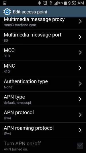

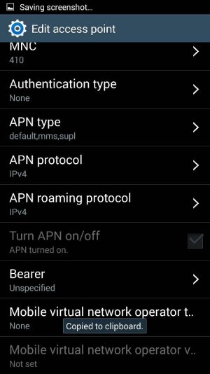

Ya know, I originally thought it was the APN settings. Here's why. When the port was complete, I received a text saying welcome to AT&T! The phone worked. I could call, txt, data was the fasted I've experienced on any phone. But, I couldn't send or receive MMS. StraightTalk customer service warned me this may be an issue and if so, change the APN settings.
I changed them to what they recommended, then I had no service of any kind. That's where the trouble started. I've reset to deafults, created new ones based on what I had read on xda threads. Nothing has resolved the issue.
I read somewhere that you sometimes have to clear the cache partitions when APN settings become an issue so I did that as well.
Aside from the camera issue, which I'm confident can be fixed, it's a great phone unless I'm near home. As I type this post, I'm in another county, far more back woods than the area I live in, and my srvice is impeccable.
As always, if you have any suggestions or tips regarding the APN settings, I'd be glad to give it a go. I'll post the current settings.
