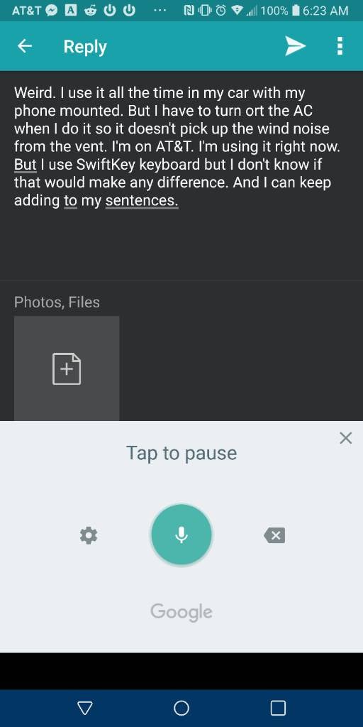

Re: Speak to text not working properly after installing Oreo update on AT&T LG v30.
Weird. I use it all the time in my car with my phone mounted. But I have to turn off the AC when I do it so it doesn't pick up the wind noise from the vent. I'm on AT&T. I'm using it right now. But I use SwiftKey keyboard but I don't know if that would make any difference. And I can keep adding to my sentences.
