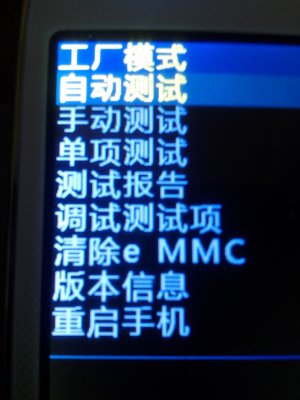

help i just got a s4-gti9500 from hong kong unlocked and i need to root it but i cant get it into download mode when i do it it said factory mode and then a bunch of chinese words that look like stock recovery any information would be good i did call samsung and they did confirm that its a real s4 IMG_20130929_160611.jpg

ok so i got it rooted now but i still have no way to get it to download mode as it seems that the buttons are configured different holding only the power and the vol + is the only way to get it to stock recovery i have tried every way to get into download mode but just reboots the phone every time any way of getting Odin to work any other way because i need to put CWM Recovery in to this to change roms

Steven, I'm having the same issue with my phone. I can't get it to go into download mode. It comes up with same Chinese menu as your screen shot. Were you able to figure it out?

help i just got a s4-gti9500 from hong kong unlocked and i need to root it but i cant get it into download mode when i do it it said factory mode and then a bunch of chinese words that look like stock recovery any information would be good i did call samsung and they did confirm that its a real s4 View attachment 83904
tente instalar o Google translator em um dispositivo com android acima de 4.1 ele le a imagem da foto e traduz para seu idioma.
http://tecnoblog.net/wp-content/uploads/2012/08/google-translate-imagens-600x337.png
