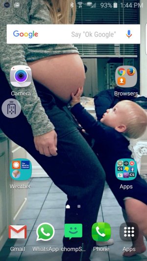

Yesterday I noticed this floating remote icon on my screen. Looks like a remote in a gray circle. I didn't add any new apps. Anyway, if I press it my phone just freezes. All I can do is move it around.

That Peel remote is an app to control the IR blaster. It started to give problems to many people a few days ago. Some members have reported that the devs released an update yesterday that finally fixed the problem. You can check that in the Play Store. If you don't use the IR blaster the best thing could be keeping this app disabled.

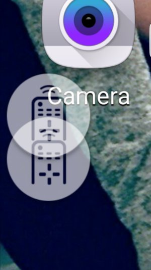

Thank goodness I know I'm not going crazy. It appeared yesterday, floating on my S6 Edge desktop, doubling itself to 2 icons and then creating a virtual screen protector that completely disabled my ability to do anything. I couldn't power off, restart, nothing. I've tried to attach a photo, screen shoot that I managed to get. The only way I found to defeat it was to hold the volume down button, power button and home screen button for a long time which eventually led to the Safe Mode reboot mode. Then, it disappeared. There's no sign of it. I downloaded virus software, it scanned, found nothing. This is some nasty stuff. Makes a case for that crapola Iphone!Virues S6 - 1.jpgVirus S6 - 3.jpg

As noted. Hold down the Down Volume, Power and Home Button for as long as it takes to reset. For me and others this makes the phone reboot and the Remote App thingy "seems" to be gone. I also have S6 Edge, Hmmmm...
