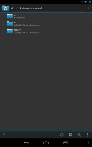

Yeah it looks like there are a lot sym links around on here but rt these are my two choices. Which one should I keep and which to get rid of? I got the whole SD backed up to my PC anyway so not much risk involved
I forget but the one that has your backups, like your cmw backups, you transfer those backups to your current sdcard, and anything else in there u need, then feel free to delete it

OK I deleted the 'legacy' folder it erased both my SD card and the 0 folder. I started adding back the files I want from dropbox but I now have 2 folders again.
[Edit] Which folder exactly should I delete?

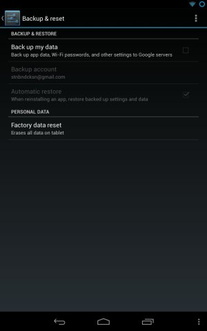

So if I return to stock 4.2.2 it will correct the problem? Then re-root and flash CM 10.1 again.
Sent from my Nexus 7 using Tapatalk HD
Return to stock ROM and stock recovery and then boot ROM and run
System settings>Backups & reset > factory data reset
Ok. I'm about to run a quick back up then I'll given this a try.
