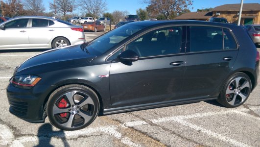

Continuing to work the problem, I:
  • Disabled HTC Sync on my phone
  • Disabled the standard "Car" app on my phone
  • Uninstalled and reinstalled Android Auto (AA)
  • Turned off Bluetooth
  • Plugged phone into USB before starting Car
And today for the first time I was able to connect, and then quite easily re-connect a 2nd and 3rd time. By only plugging and unplugging phone when the car is OFF.
VW may not be as simple to connect as Hyundai, but I have the feeling more of the problem is related to the extremely fractured software images on our wide variety of Android phones, along with the various apps added by our various phone vendors and carriers.
My latest advice -- keep disabling EVERYTHING that wants to start up naturally when you plug your phone into a USB port.
Good Luck,
Chris
2016 VW GTI SE -- Carbon Steel Gray
HTC One M8 - Android 5.1 (should be Marshmallow by this time next week -- come on T-Mobile)
