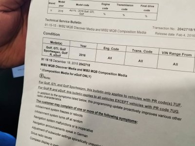

I called VW service today and determined that there is a newer software version for my head unit, and it's supposed to address these issues. I'm taking my car in Wednesday, so I'll update after that.

Have you had chance to install the update? Do you know what the new version number is or if there I way ai can check to see if there should be an update?
Yes, I had it installed today. So far so good.

Awesome, I'll have to give them a call and see about getting a booking to. Hopefully the update has made it's way to Australia (not sure where you're from).
Edit: Booked in. They said there 'might' be an update available, but they need to check it first. *crosses fingers*
I'm in the US. I suspect the update will be around. The dealer I called didn't know and told me I'd have to bring the car in and then they could check. But I told him to look it up. In the system menu we obviously have the hardware version and the software version (which was 024 before and is now 025).
So he got his manager to look it up and it was available.
Hmm my software version was something like 0613 last I checked. I'll have to check. Your picture shows release date Feb 4 so I'm assuming I'm not up-to-date then. Great job, I'll have them update mine when I can! Keep us posted as to how Android Auto runs! Peace!
