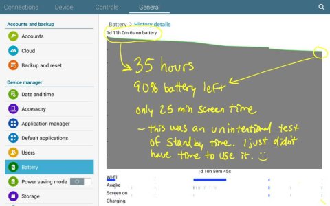

I didn't have much time to use my tablet the last two days. And I kept WiFi & screen off except for about 25 minutes. But, I never shut it down completely, just closed the case.
I was able to get 35 hours on only 10% battery. So there is 90% left. Theoretically I could go like this for 350 hours (14 1/2 days). Pretty amazing. See the attached screen shot.
But, why would I have a tablet if I only used it for 10 minutes a day?!!!!

Goin_nil's exceptional standby times are in large part due to the fact that nothing is establishing a wakelock as evidenced by the low number of tick marks in the awake line on the battery summary screen shots being posted. The kernel on these tablets is very good in terms of bringing the cpu down to a low power state when usage is minimal.
If yours is dying fast in standby then something is running in the background keeping the tablet awake and you'll see that in the battery summary page. To figure out what it is you'll need to pay attention to what applications are ranking at the top of the battery usage list. Using third party battery monitoring tools helps find wakelocks too (like Better Battery Stats or GSAM Battery Monitor).
Sometimes an application goes rogue, and sometimes it's merely that sync settings for certain applications are set frequently enough that the device hardly sleeps. Imagine for example if a dozen apps were set to sync every 15 minutes but they each fired off a minute apart. Overnight the cpu would have very little time to rest.

Goin_nil's exceptional standby times are in large part due to the fact that nothing is establishing a wakelock...
That's a great point @muzzy996. Recently I've been trying to do a few things when I know I'm not going to be using the tablet for a few hours. I read this on some forum, maybe this one.
1. Force close all apps from the recent apps list.
2. Clear the RAM.
3. Turn Wifi off.
But, I don't turn the tablet off. I just turn the screen off (ie close my case).
I checked my battery graph during the times when I've done this and the battery percentage has been a flat line for hours, even over night it did not drop one percentage point.

I love my Note Pro . . It gives me the best battery life I've ever seen out of an Android device. I never thought I'd see the kind of standby times that I do with one, but I'm able to leave Wifi on 24-7 without worry and walk away from the tablet without fear of returning to a battery that has been significantly drained 24 hours later. At most perhaps I'll see a 10% drain overnight but it is more common for me to see much less than that over 8 hours that I'm sleeping.
On light usage I can get well over a week.

Guess it depends on room conditions but typically for me I run my tablet at perhaps 15% brightness at home in the evenings and 30% to 50% in the office during the day.
That battery stats page in Settings-General-Battery is helpful in determining battery consumption.
Tapping items ranked in the list below the graph and paying attention stay awake stats for example can assist in determining applications that are keeping the tablet from fully sleeping when not in use leading to high drain in standby.
Tapping the battery graph itself helps determine how much time the tablet stays awake vs having its screen on. If there's a lot of tick marks on the Awake line while the screen is off then you're likely going to see more drain during standby for example. Also for LTE device users there will be a colored indication of signal strength which should also correlate with rate of discharge at the top. Low signal strength will result in increased drain in standby.
