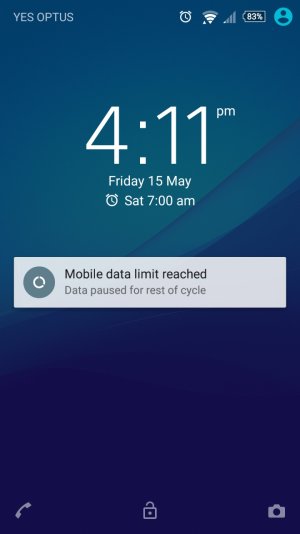

Also now, I get Data cap is used, I know this and i wont go away
Whats up with these annoying intrusive notifications. Does android think we are dumber now?
This one one of them
There is no way to dimiss this unless you go to the process of the app and disable all notifications
Which is really really stupid, this will disable everything about data
I put a cap on my data so I dont go over. And it needs to tell me every time I look at the phone. Like I forgot .. 5.0 sucks
I can understand why they might make that notification non-dismissable. It's telling you that you can't use mobile data, so they probably figured it's something that has to be a persistent alert, in case the user forgets. But I can also see how that can be annoying.
The data overage notification I haven't gotten on my Z3 but on my M8 it wouldn't go away unless I removed the data limit.
