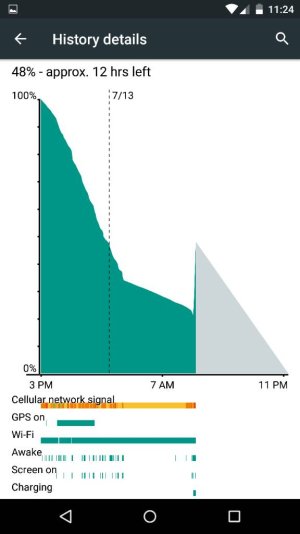

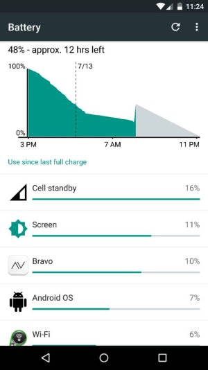

Here is what my current cycle looks like. Terrible. Bravo is a work app. There has to be a way to boost my signal. I live in the middle of Phoenix. Is it a possibility that if I were to get this device replaced that a newer device might help?
