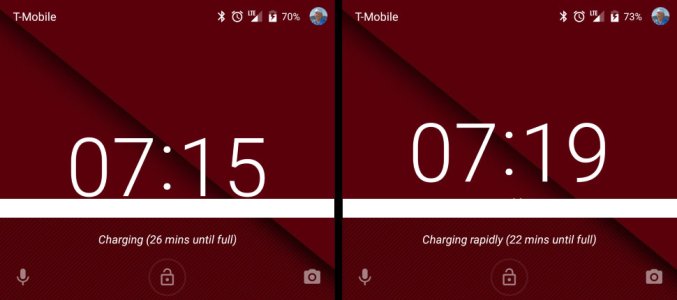

Just because Google promotes only USB Type-C charging does not mean that other fast charging methods aren't also supported. I've verified (using a USB Type-C adapter) that my new Nexus 5X will fast charge on a Ventev Quick Charge 2.0 car charger and on a PowerGen 12W wall charger (using a USB Type-C adapter). The phone does say "Charging" instead of "Charging rapidly", but the actual charging rate is still fast, comparable in speed to the included USB Type-C LG charger.​ (In the image below, PowerGen on the left, LG on the right, both charging at about 1% per minute, roughly the same as my old Nexus 5.)
Use an app like Ampere to show the actual charging rate.
