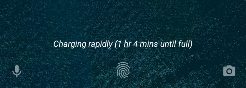

When you plug your cable into your device, do you see the "charging rapidly" on the lockscreen?
Yup. but if I'm using the device it'll say something like (11 hr until fully charged). If I leave the screen off for a while it'll say a normal charging time.

Yes. I measured the charge current externally, watched debug messages and tried to get a clue from the source code where those messages come from, and come to the same conclusion.
The charge current seems to be limited if the screen is on (the temperature of some component seems to play a role here). In my case it typically drops to around 600mA. Reducing the current during screen on may be reasonable at some point, however those 600mA are just not enough to at least keep the phone at its current battery level.
Especially if using Google Maps etc., I'm wondering how this is supposed to work on longer trips.
After searching a bit on google, it appears as if the LG G4 has exactly the same issue, which is propbably no surprise.
Same manufacturer, same chipset.
I hope, LG will be adjusting this current limit to at least 1A or something more reasonable.
