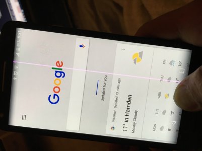

IMG_3479.jpgIMG_3242.jpgseems like my story was written by a decent writer:confused: Once I woke up and saw what you can see on the attached image, a famous green/pink line issue. That was my chance and I made the most out of it. I chatted with Verizon representative and since my phone was still under the warranty chat rep was kind enough to send me a free certified used phone (which ended up being a phone looking new without a single scratch). I had been preying for two days for the new phone to have Lollipop and guess what? It actually had lollipop when I opened it. Took me round two hours to reinstall all the apps etc. (thank God Nova Launcher allows settings import, saved me some time) but now I have my droid turbo back as I've been on wifi and not a single issue even though my network signal is poor where I'm now.
Now I just need to stay away from marshmallow.
