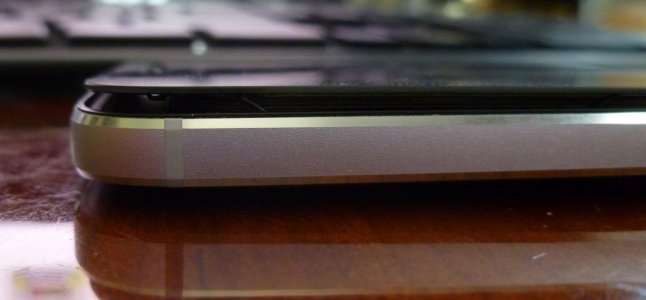

I have the Spigen case and I noticed the edge today was sticking out of the case. I thought the phone popped out of the case at first. It turns out my screen is coming off. I never broke this phone or replaced the battery. It's stock all the way. Now what do I do?
Re: 6P screen is peeling off!
I just noticed it takes a tremendous amount of pressure to push the screen back on, I wonder if the battery is puffing? It's the lower right edge.

How long have you had the 6P? That's a really bad quality issue there and may be dangerous if the battery is swelling

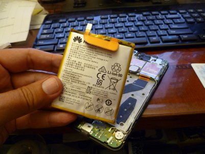

Google was a waste of time. I won't be buying a phone from them again. Support is useless. I followed a few how to take this apart videos and the battery is puffed. This is one PITA phone to disassemble. I am going to assume the battery pushed the screen out. I read somewhere Google recently sent out an update that checks for legit batteries and the phone won't operate with a non-approved battery. Not sure where I can be sure one is legit?

I ordered a battery on eBay, reading around going direct to H was not an option either, they don't sell parts. I'm going to buy an S8 if this does not work. Last Nexus or Google branded device I will ever buy, Google does not understand how to support hardware. I can find a bunch of articles on this screen lifting and Google says it's never happened before.
