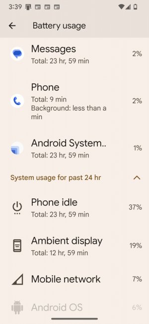

7 Pro - very poor battery life
Well the AOD is taking a bunch, maybe kill that feature. Do you have 5G available? Maybe try switching to LTE. I don’t have 5G here, maybe why my battery is so good.
Android System Intelligence seems to be on all the time -- it's not using much battery in itself, but it tracks with your Phone Idle, which seems to be what's using a lot of battery. My Android System Intelligence definitely does not show that duration of battery use.
Are you regularly using any of the ASI features, listed here? https://support.google.com/pixelphone/answer/12112173
You could try clearing the cache and data for ASI in the Settings>Apps​ menu.
EDIT: I just noticed that Messages is also on constantly. My Messages battery usage shows a total of 1 hr 48 min at this time, and certainly not 24 hrs (even though battery use is Unrestricted for that app). Try also clearing the cache/data for Messages and force stop it, then open again.
