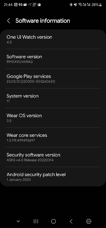

What firmware are you on? I posted just a bit ago what I think I am on. I don't seem to be having the same constant unlock and battery drain issues that you have. What apps do you have on the watch?

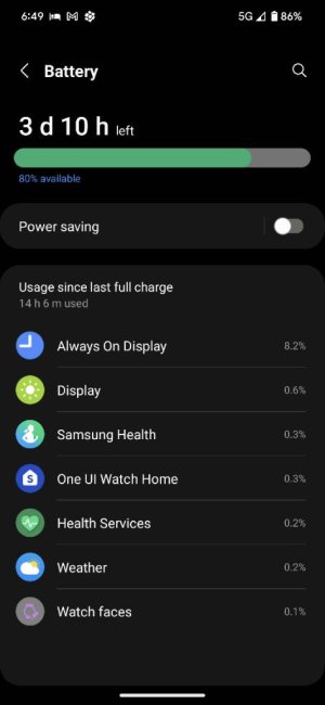

Yeah I'm not having these battery issues that some people are posting here. Screenshot_20230130-184905.jpg
Oh yes, sorry, you did already post your software version. I am on the same release (info below.)
