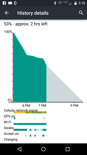

Vent mount: Unfortunately the issue hasn't changed. Here is a screen shot taken after my commute home. The phone was 100% when I took it off the charger. After rebooting it resumed normal drainage but then the issue happened again some time later on. This time I was at home busy not even using the phone.
When I look at the biggest sources of drain on the battery I see Google Play Services heading the list. With Screen way down the list.
For the last few days I've been experimenting with killing all apps when sleeping the phone and it seems much better behaved. That's a PITA but worth it if I stop finding my battery on its last legs with no explanation.
-Dennis-
I finally bit the bullet on the 17th and did a factory reset. This fixed the issue. Battery usage is back to normal. The thing is I don't see any difference in percentage across apps. Usage is unchanged but the battery is behaving much better. It almost seems that the processor itself ends up stuck in a high performance mode causing the fast drain.
