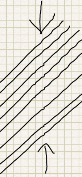

I've tried using a straight-edge, but the results are the same. Most lines come out a bit wobbly, but the biggest problem is an area to the left, and a bit down, from the screen centre-point. In that area lines will "spike", and its more pronounced the slower I draw them (with straight-edge). It seems like certain spots in that area will cause the pen position to jump to the right, then back again.
When drawing multiple lines with small spacing, the spikes will be right above each-other no matter where the lines begin or end.
I've attached an image so that you can see the effect. Note that it's almost only happening on diagonal lines drawn from top-left towards bottom right.
