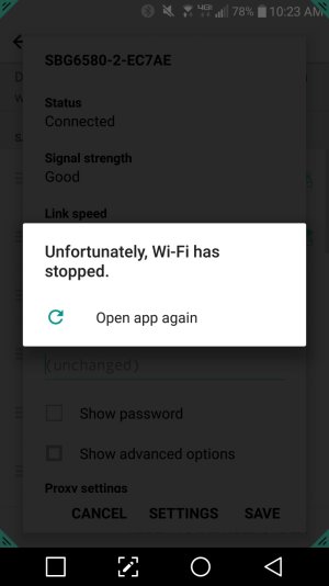

Having issues with phone going slow on an excellent Wi-Fi connection. Was going to try to switch to a static IP to see if that would help. I can go to advanced Wi-Fi, manage networks, choose my network. But as soon as I click "show advanced options" the Wi-Fi settings close (image attached). Anybody else having this issue?

I'm assuming you have already tried a reboot? Can you walk us through (step by step instructions) as to how you got to that screen with the "show advanced options" checkbox....I can get to those options differently, by clicking on the right top corner three dots after Settings -> Wifi. The settings are not specific to one network.
Yes, I've rebooted. I go to Wi-Fi settings, 3 dots in corner, advanced Wi-Fi, manage networks, select my network, modify network, then I click "show advanced options" and it stops running every time, on any Wi-Fi network.

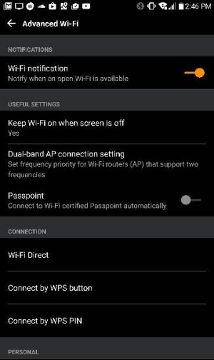

It might me network specific. I got nothing for manage networks under advanced Wi-Fi...see below:

This is my advanced Wi-Fi menu. Verizon LG V20 VS995
That explains the difference, I have an unlocked B&O model with no carrier modification. Have you tried playing your router settings to improve your speed? The advance Wi-Fi will only give you access settings like WPS, Dual Band priority, VPN certs & etc. These would only help if you were having issues like connections drops or any other Wi-Fi Access issue.

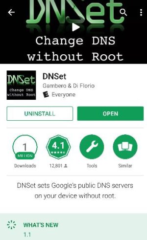

Ok...so I disabled ipv6, set dns servers to 8.8.8.8, 8.8.4.4, used a reserved IP address. Still didn't work. For the record, not everything was slow. Like I could stream a basketball game no problem, just that apps that should load in milliseconds were taking a minute (ok maybe only seemed like a minute, but like even Android Central would take 30 seconds to load a thread). Facebook, Snapchat, took forever, even failed to refresh at times. Then I came across an app called DNSset today, which basically does everything I thought I already did (force phone to ipv4, use Google DNS server) and it WORKED.
