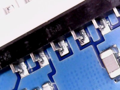

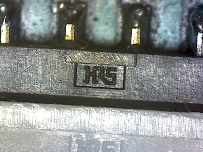

Solder should be added as much as possible to secure the connector like this
The original has a very weak solder joints, that's reason the connector tend to be cracked due to the flexible LCD which the mainboard sit on it.
Battery connector should be reworked for every Samsung tablets as I see this problem is very common from 8 inches, 10.1 and 12.2 inches tablets. I do this rework for every Samsung tablets I
bought, especially 10.1 and 12.2 tablets, then I have never seen any problem of quick discharge, or slow charging battery.
