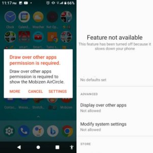

William Hale3 Well-known member Apr 15, 2020 63 0 0 Jul 2, 2022 #1 Android 8 didn't have this problem . . can I override it using a C5L MAX ? Could it be one of my cleaner apps ? Attachments IMG_20220701_232324.jpg 27.4 KB · Views: 9
mustang7757 Admin Moderator Moderator Feb 6, 2017 99,140 15,857 113 Jul 2, 2022 #2 I'm not familiar with C5L MAX but if it's low spec then most likely don't have the option to turn off but tap.setting in the pop-up see if it takes to toggle it off . Upvote 0 Downvote

William Hale3 Well-known member Apr 15, 2020 63 0 0 Jul 2, 2022 #4 . . it is indeed a low spec BLU phone featuring Google Go no where . None of the current video recorders work / same for the toggle . Upvote 0 Downvote
William Hale3 Well-known member Apr 15, 2020 63 0 0 Jul 2, 2022 #5 Thanks . . I toggled the dev setting and it wouldn't budge . Guess I need a new newphone . Upvote 0 Downvote
B. Diddy Senior Ambassador Moderator Mar 9, 2012 169,743 11,166 113 Jul 2, 2022 #6 Android Go does not support Display Over Other Apps. That feature typically requires more RAM than Android Go phones usually have. Upvote 0 Downvote
