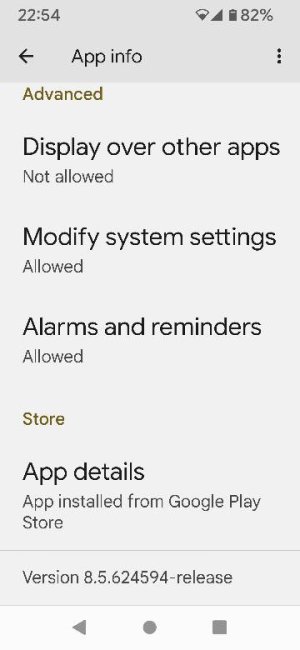

Hmm what version of Android Auto do you have? Is it beta?
Sent from my Pixel 7 Pro using Tapatalk
Weird that's the same version I have. What's strange is when my phone first connects I can use hey Google to start navigation with Waze but once that's running it no longer works.
