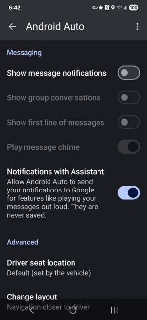

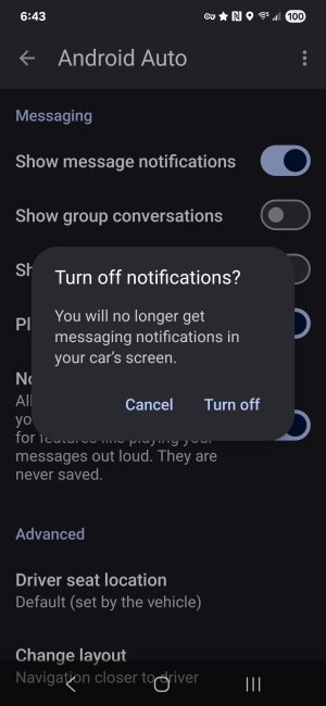

I have "Notifications with Assistant" turned on. If I turn that off I get a pop-up that says I'll no longer get notifications on my car's screen. I still want the messages on my car, I just don't want them to be automatically read... What am I missing?
