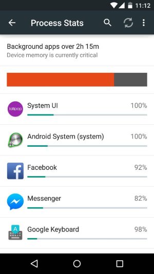

Could it be a case of Google Services gone wild?

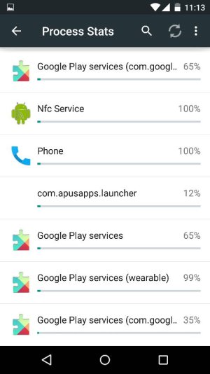

Would you mind heading into developer options > Process stats > Analyse your stats > Post screenshot here?
My Nexus 5 has been having odd experiences with Lollipop, while for the most part everything seems better there have been days when it disappoints.
Recently I've noted that at some point of usage Google's services can start taking up a lot of RAM, making performance worse(and in the process battery a lot worse too).

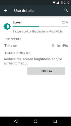

A simple reboot fixed my issues, and I yesterday tested the battery with heavy usage(mainly social networking applications with WiFi) and I got around 4 hours of SOT:
In those 4 hours of SOT, I had Google Now disabled(it is mostly enabled though). Location and WiFi was also enabled and my phone was using the trusted faces feature. I was doing texting using WhatsApp and Facebook Messenger for 4 hours straight and I used the amazing built-in battery saver of Android Lollipop when battery fell at 5% and got quite a lot of extra juice in the last few minutes!
I would recommend disabling location, or turning it to low power mode. Disabling Google Now. And using Lollipop's battery saver whenever your phone falls below 15%.
If that doesn't work factory reset, or maybe even revert to KitKat 4.4 using a factory image.
And if that doesn't work, your greatest fear may become a reality, the battery of your Nexus 5 may have started depleting(which is common for most batteries to do).
