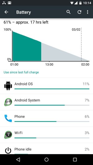

I just bought the nexus 6 and I noticed a problem on the battery usage. I unplugged the charger at about 1am and left the phone totally idle until I woke up at 10am. The battery went down to 61% from 100% and the battery drain was mainly contributed by the Android OS. Below is the screenshot of the battery usage:
Is this normal? Is there any solution to stop the battery drain by the Android OS?

Welcome to the forums. I am guessing you got an update to 5.0.1? If so, did you do a reset or at least a cache clear in recovery?

Ya, just upgraded to 5.0.1, will try the above now and see if they help..
Thanks :)
Factory reset + cache wipe in recovery mode solved the problem!
