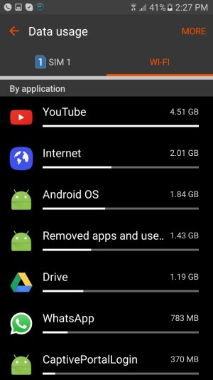

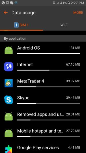

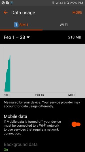

hi I have my S7 edge with the same issue (very high data usage by the android os with moderate high battery usage)
android os utilize 130mb over three days out of 210mb total data used over the 3 days
my sync is off
no back up enabled over data or restore of any kind
no facebook app nor messenger
Screenshot_20170203-142700[1].jpgScreenshot_20170203-142707[1].jpgScreenshot_20170203-142737[1].jpg
i removed most of the apps and the situation continues
any suggestions?
