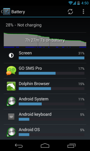

I'll post screen shots later but it's down to 73% with 3 hrs and 30 min on and only 50 min screen on time. Mostly Wi-Fi. I'll get screen shots tonight so maybe you can help me.
corance
Nov 3, 2012
453
Visit site
Now I'm at 33% with 7 hrs on and not even 2 hrs screen time. I'll post pics when it's about dead so maybe someone can help.
corance
Nov 3, 2012
453
Visit site

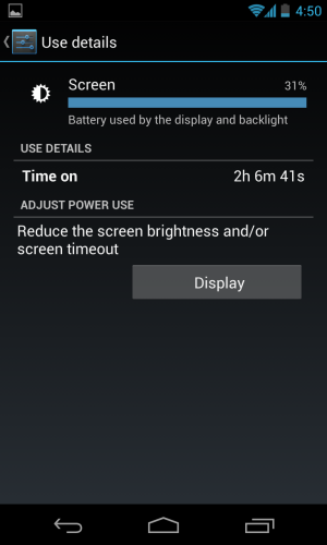

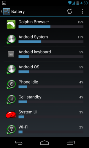

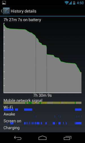

If you need any other info let me know. I'm running Franco kernel BTW. This isn't good at all. Others are getting 16+hrs with a few hrs screen. What's going on here?
The Android OS drain is a bug. That is why Google is about to push a patch 4.2.2.However, if your having Android System drain, make sure you've opened all the following apps at least one time so they can sign in, regardless if you use them or not. As these are system apps, they will keep sys running until you sign in.
YouTube
Google Earth
Google + (I then disable all the sync stuff in g+ settings)
Chrome
Currents
Maps
Play Music,Magazines, Books, Music

ok i signed into all of those and disabled all auto sync on everything i dont use. I did have all of those that i dont use disabled...wonder if that matters? Would disabling systems apps cause Android System to run so much? I dont use those apps at all, why not disable them?

See, what the hell? What am I doing wrong? I have maybe 7 apps installed and almost all auto sync off! What should try? 8hrs with only a couple hours screen is garbage. Its really Android system thats way up there. If you look at the battery graph it just starts dropping all of the sudden. I wonder whats going on?
I would enable gapps that come on the stock nexus and ensure they are signed in as mentioned. With the way they have the tight gservices integrated into jb, gapps are vital, even if you don't use them. Apps often cross access each other. I had the same Android System drain until I made sure the following steps were satisfied.
If I were you, I would charge back to 100 and factory reset, then take care of the gapps. If you do that I'm sure you know it will erase all your user data. Be ready to start over and lose all your pics, vids, etc. so make sure you have a good backup.

Try without the factory reset first. Just re-enable all the gapps you have disabled, clear their app data in settings and then open them all (listed earlier) so they can sign in.

If you look at my screen shot you'll notice the mobile network signal is horrible. Just a few green streaks, but I was on wifi most of that time. I didnt know your mobile network signal mattered when you're on wifi. If it does matter, that could explain some of the battery drain...i mean look at it. It barely has any green at all!

You did right. Since the gapps are system apps, they need to remain updated, enabled, and signed in. I think you will find the Android System drain will pretty much disappear, and Android OS will become your new #1.
