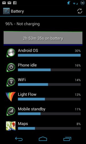

I took the phone off charge at 100% and did not touch it for about 5hours and the battery was down to about 70 - 75% with Android OS at the top saying 30% is that normal because i didn't use the phone?

this is definitely not normal. Your phone should be in deep sleep mode and use almost nothing. If I turn my screen off at 100% and turn it back on 5 hours later it will use maybe 3%. Something is amiss in your apps or settings. Imo.

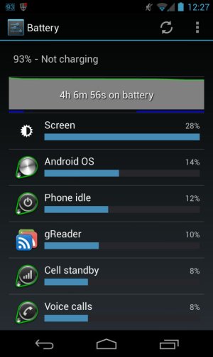

I have Viber, Tango and Skype but I'm not signed into Skype. This screenshot is with mobile data turned off and me not touching the phone since it's been off charge about 3 hours, only lost 4% battery.
Install better battery stats to check if any weird wake locks are keeping your phone from deep sleeping. I am currently on minco v6 ROM with Franco r28. Fully charged last night at 11. Woke up at 6 and battery was at 5%.

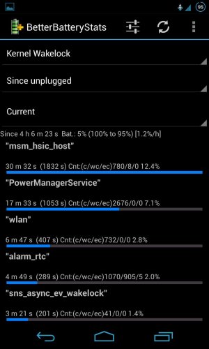

Really, install better battery stats and check the kernel wake locks and partial wake locks. One time my battery was draining really fast and I had suspend backoff kernel wake lock keep waking my phone up. Took a long time but realized my 5g WiFi connection at home caused that for some reason. After switching to reg WiFi, that wake lock was gone and my phone returned to deep sleep.

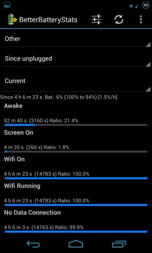

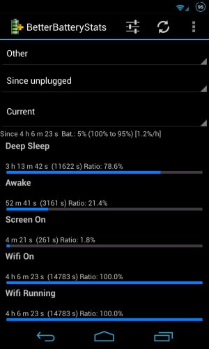

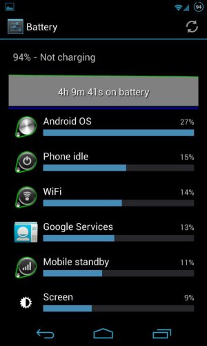

There you go took it off charge 4hrs ago and didn't touch it screen off
I think you have a faulty unit. Those numbers aren't horrible as sometimes the battery will drain faster for the furst15% or so. I would do a factory reset to see if you get the same results. If not then it's software. If you do I would call google for a replacement. Lots of people who got replacements had better results.
Is there anything in those screen shots that's keeping my phone awake? I thought this was quite good compare to a few days ago when i lost 30% in 5hrs with the phone untouched. Should it be better than this?

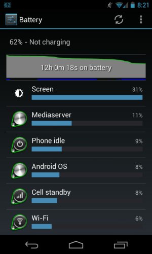

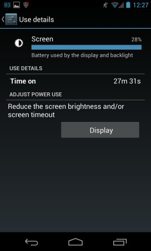

I think that looked pretty normal. Here's mine from today. Wasn't using it much. A short phone call and minimal usage.
Yeah... the android os isn't that big of a deal for much unless you don't use your phone like any
