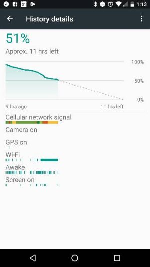

I don't know about that. Signal seems to be better for me. On Fi, but so far the doze feature seems to be spot on.

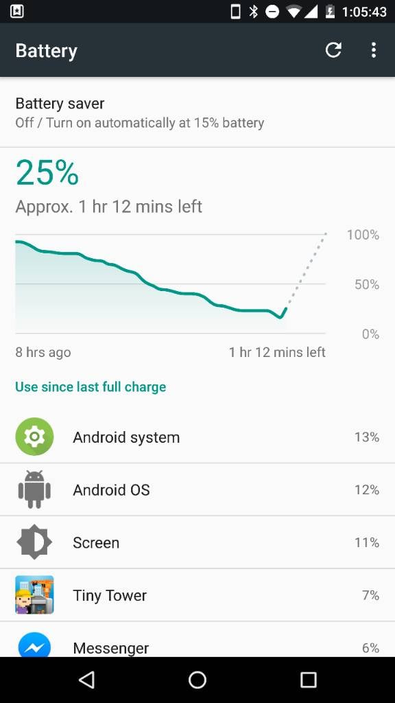

I thought they were gonna fix the battery drain with the new Nougat, but it seems it's still there. Android System usage sometimes hits 82% at my Lollipop, it's at least about 15% here, still at the top, tho..
