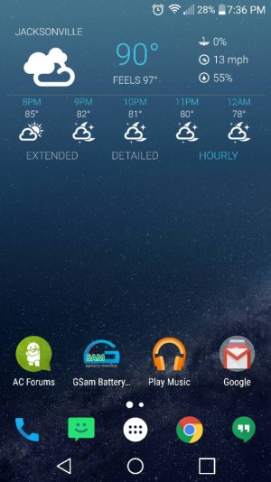

I am using the Anker QC charger but it doesn't seem to be doing quick charge. My S6 would not take this long.
I do have the international model so not sure if that matters.
The note 4 does around 9v/1.67a or approximately 15w. My guesstimate is that if it did support qc 2.0, it might be around 11w,perhaps 9v/1.2a, which is still using the quick charge 2.0 standard, but at a lower level. Now the Anker can do 18w,9v/2a.
Sent from my Verizon LG G4
