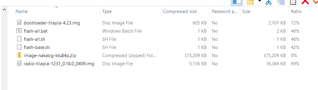

I've downloaded it. Here is what is in it:
2017-01-08 13_24_58-C__Users_Steve_Downloads_nakasig-ktu84p-factory-ddaf3885.zip_nakasig-ktu84p.png

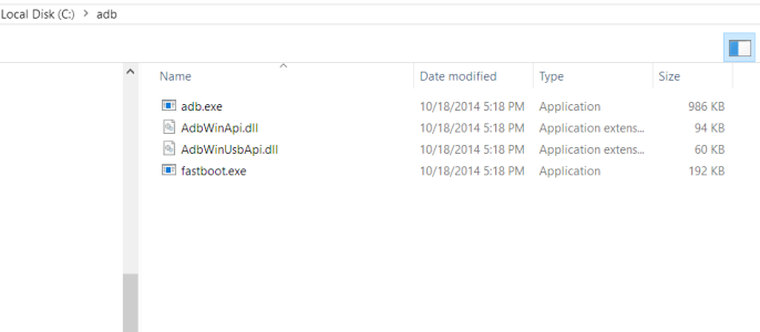

I don't know what to do next. I have downloaded and installed an adb setup file that has extracted to a directory on my C drive:
I'm not clear what I do next.
At the beginning of the flashing instructions, it tells you to run flash-all.bat (on Windows).
You may need to edit it first, to ensure the path includes the directory fastboot.exe is in.
In the 4.4.4 (KTU84P) directory that I posted a screen shot above I do see the flash-all.bat file. I have placed the contents of that zip file that I downloaded into a folder I have made at C:\android4

I have edited the Path in the flash-all.bat file to point to a c:\adb where fastboot.exe is sitting.
PATH=c:\adb
When I run flash-all.bat I get:
'fastboot' is not recognized as an internal or external command, operable program or batch file.
Are you sure you obtained a valid adb package?
If you call adb or fastboot explicitly as in c:\adb\adb.exe or c:\adb\fastboot.exe what do you see?
If they act like normal commands, then you can call them explicitly in the batch file.
