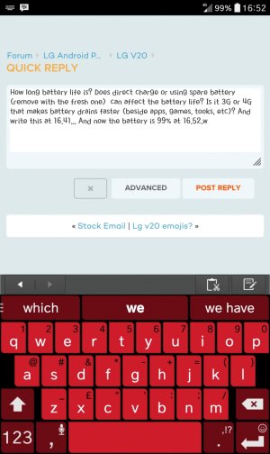

How long battery life is? Does direct charge or using spare battery (remove with the fresh one) can affect the battery life? Is it 3G or 4G that makes battery drains faster (beside apps, games, tooks, etc)? And I write this at 16.41... And now the battery is 99% at 16.52,with normal apps (without any single launcher, drawer, and any kinds of those) and I just open this window. Is it good or not, mates?

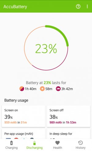

I am losing between 400 and 600 mAh per hour. They are telling me my phone will last a little over 2 hours. I'm at 85%.
This can't be normal

This has got to be the worst battery day ever!!!! I'm actually using my phone less than normal.
Any one else having problems posting pictures?
I have screen shots but I get an error when posting them

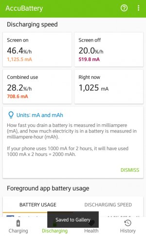

I screenshot these at 23% now I'm at 16. It hasn't even been 30 minutes

Wow... You have A LOT of apps that need updates. Any reason you don't keep them updated?
If I like the way an app is running, I won't update it out of fear of losing functionality. That's why I don't have it set to auto update. The rest I just don't think about it. Think it will help?
I don't auto update either, I do it manually so I can be selective but I think it's best 99% of the time to keep them updated.
Help? Maybe. What might help you the most is finding an alternative to Facebook, like Metal or Friendly. I don't use Facebook but I think those are the ones most recommended. Should provide mostly the same experience with the battery draining.
Click on Facebook in the battery section to show how much data sent/received, radio activity time, etc. Facebook is bad on battery, but not that bad.
BTW, Facebook mobile by using the browser is about 99% identical to the app. I might even say its 100% identical. And it won't run in background, only when you are using it. Then just add a shortcut to your desktop. The battery difference is dramatically reduced by using the browser.
