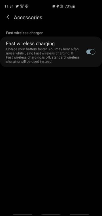

The only option under accessories for me is Fast Charging.
I have the s10 plus and the only option I have is fast charging.
Same here for s10 because I don't use the flip wallet cover. My wife does on her s10, and she has those settings under Accessories. It's an app that is downloaded to allow additional flip cover settings.
