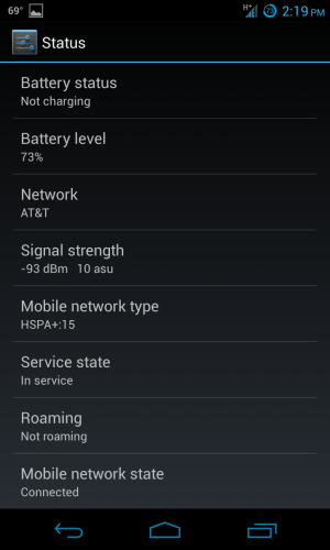

H+. It idles at H and immediately switches to H+ when there's a demand for data.
Interesting. I'm on post paid and have never seen the H+, even though I'm getting the speeds. I know mine is doing the same. When I check mobile network type, I get HSPA:10 when idle and HSPA:15 when in use.
Sent from my Nexus 4 using Tapatalk 4 Beta
I know the stock ROM does exactly what you're describing. Some custom ROMs have the H+ symbol, I'm on CyanogenMod 10 personally. As long as the mobile network type says HSPA+, that's all that matters.
