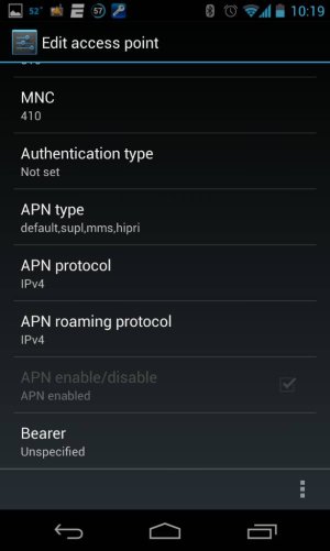

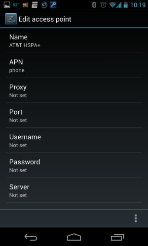

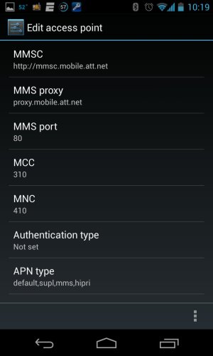

The process at AT&T was extremely easy for me as well. Would you mind sharing which APN you're using?
Created a new APN
Name - att hspa+
APN - phone
Proxy - Not set
Port - Not set
Username - Not set
Password - Not set
Server - Not set
MMSC - http://mmsc.mobile.att.net
MMS Proxy - proxy.mobile.att.net
MMS Port - 80
MCC - 310
MNC - 410
Authentication Type - Not set
APN Type - default, supl, mms,hipri
APN Protocol - IPv4
APN Roaming Protocol - IPv4
Bearer - unspecified

Hmm this one doesn't look that much different than the one posted a few pages ago that I quoted. Only difference I see is the APN Protocol set to IPv4 only and not IPv4/IPv6. What does that do?
By the way I changed my APN to phone from PTA and now I get the "H" next to my bars all the time, getting rid of the problem. I'm still only getting 1-3 mbps down. Even though those numbers are low, my web browsing speeds feels just as fast as it was on my HSPA+ on my Galaxy S2.

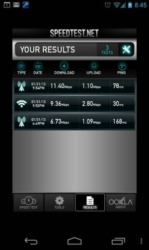

http://i130.photobucket.com/albums/p265/jimmiekain/Screenshot_2013-02-05-20-43-36_zps82b8979f.png
With the exception of one of your speed tests, those speeds are normal from my experience.
While I have peeked @ 11Mbps a few times I usually am in the 2-4Mbps range.
