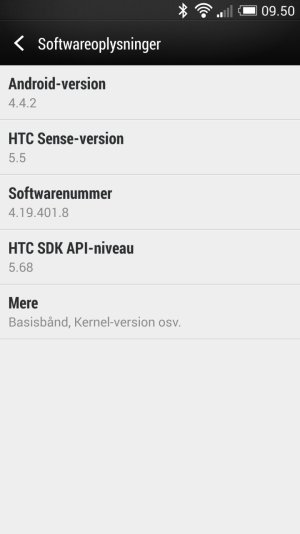

Hi, I'm a retailer from Denmark - we're having this problem on 2 htc one - my own and a
customer - problem is not that big for me as my voice compared to the customer is "high",
his voice is more "lots of singin' and beers" like - so him speaking on both phones is a problem,
we tried 10 different headsets........
today - downloading right now as we speak - a 300+ mb fw has hit my phone........maybe we're
nearer the end on this.......?
Jens

KitKat installed on my phone - and on Customers phone as well - no changes here..........damn....Screenshot_2014-01-29-09-50-03.jpg
