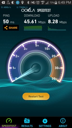

Signal strength is only one aspect. I can get good speeds even at - 114 dbm. Snr is a more important aspect, imo. I am on 20+20MHZ XLTE here.
