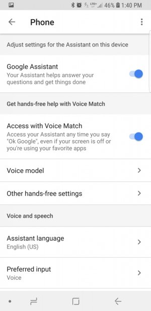

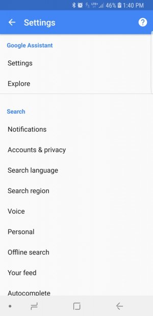

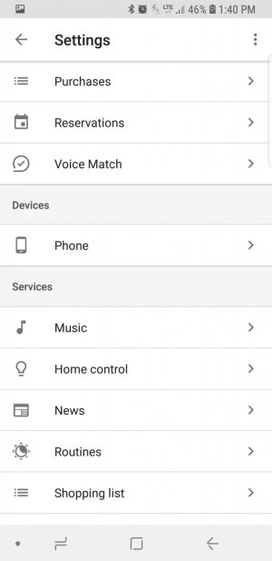

I have an unlocked galaxy s8 activated on Verizon. I am able to unlock my s8 using "ok Google" when my screen is off, and my phone does not have to be charging.
Go to Google settings, phone, "access with voice match."
